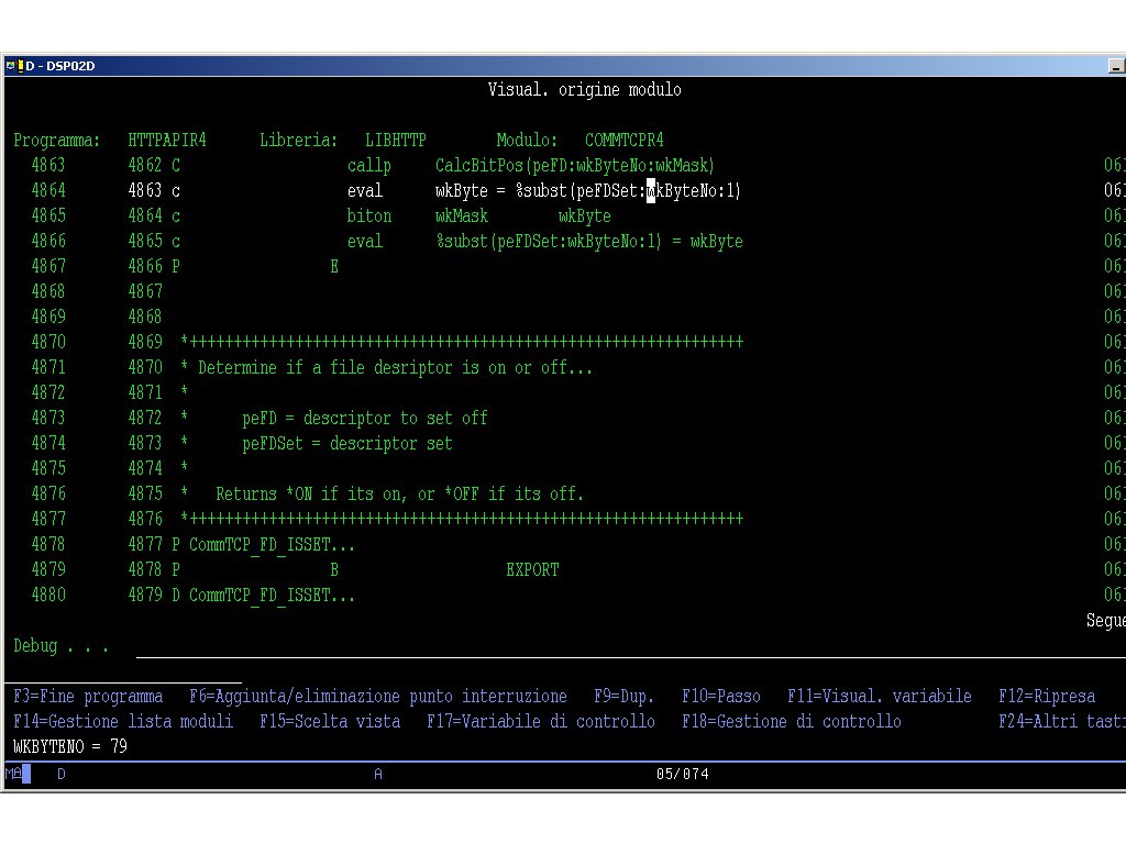

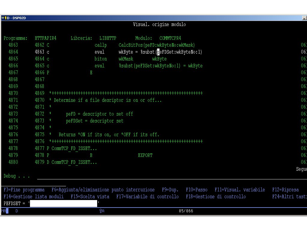

Hi Scott, I have again the error described above. I send the sccren
   shot of debug, hoping it is useful for you.

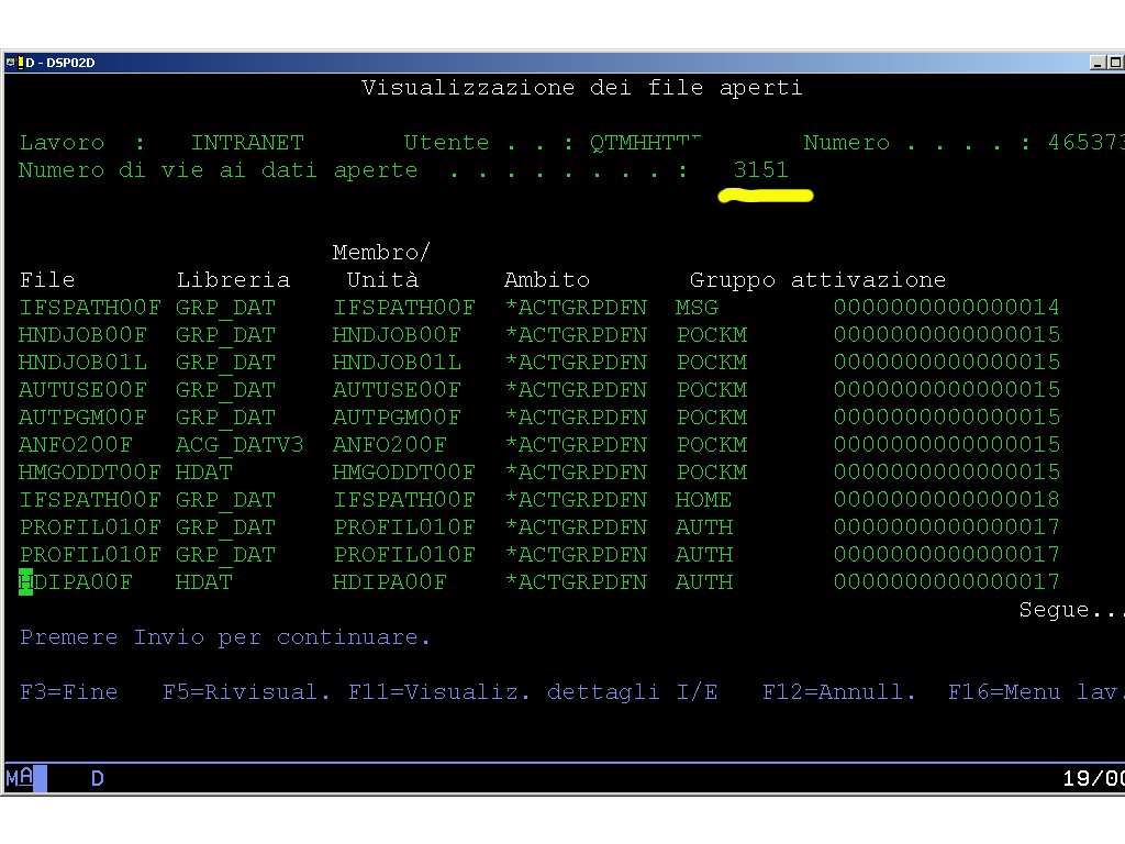

     That should, at most, result in 7-8 files open.   Not 264!
   As you can see in dspjob.jpg,  the are 3151files open; but they are
   open with sql.
   There are DEBUG_peFDSet.JPG and DEBUG_wkByteNo.JPG are the  debug's
   screen shot.

     Most likely, files have been left open somewhere.  Maybe you are
     opening
     a file and it's not being closed?   Then, after that is done enough
     times, the program crashes, and that causes the files to be closed?
