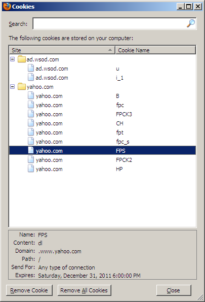

Test program attached. Last debug log attached. Firefox cookies attached. Here are the first 131 bytes of the last cookie file (it was cleared by deleting all data) (having CCSID problems getting it copied to desktop).
************Beginning of data**************
.yahoo.com TRUE / TRUE 2011-10-15-15.41.39.000000 2011-09-15-15.41.40.056000 0 0 CH AgBOcl1AAA1RQAAVzRAAFp9AABbSMAARiUAAJ88gAC2KQAA8
.yahoo.com TRUE / TRUE 2011-10-15-15.16.40.000000 2011-09-15-15.16.40.589000 0 0 CH AgBOcl0QAA1REAAVzRAAFtIQABGJEAAnzxAAPOkQACUGEAAF
 ************End of Data********************
Looking in the debug log, we can see a number of "Set-Cookie:" statements coming to us from the header and after that we can see the cookie_parse routines. We end up with only two entries for CH instead of the 9 distinct ones that firefox found. We reject or don't write all other cookies for some reason. Many are rejected for bad domain, others I assume are not written because they are either expired or "deleted" (is that a special value?). I can match up the CH in the debug file to the first CH in the file above...not sure where the second one is coming from.
Bad domain has something to do with leading "." on some and not on others? This must be some technical thing as I saw on the CH that the domain parses as .yahoo.com while the others parsed as www.yahoo.com. In firefox, I think they are shown with leading "." on both the yahoo.com and www.yahoo.com entries. Does this mean we need to add a "." when parsing?
Description: firefox cookies at yahoo.png
