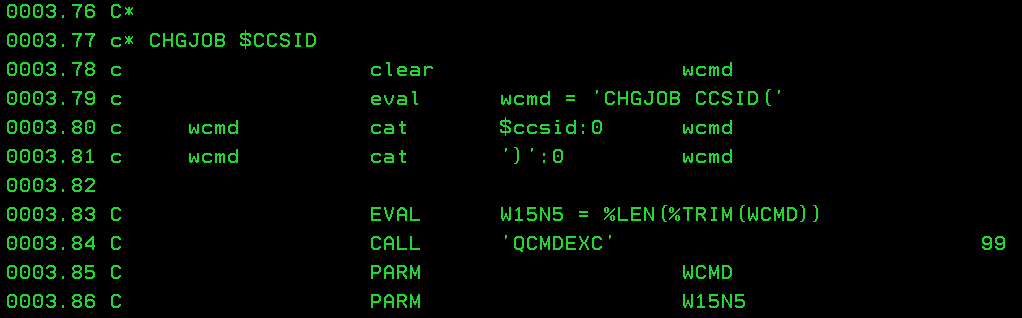

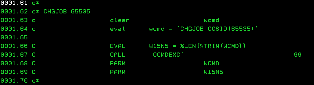

   in your program you change
   1) you change first CCSID of your job on 65535

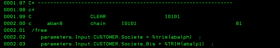

   2) Open your file
   2) READ your DATA and make the Move
   3 ) then change the CCSID of your JOB in 870 for pologn characters
   It is working for CCSID 870(pologn), 935 (simplified chineese), 37
   (US/DUTCH/SPANISH) .
   This is part of my code

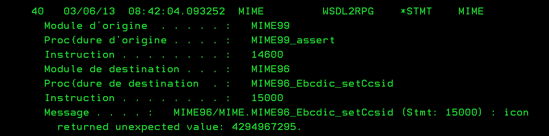

   The only thing is that i have a problem with MIME96 function.
   If i call my web service first it dump because it have a probleme on
   iconv function in MIME96 (on line 15000)
   [cid:5__=4EBBF1ECDFA39F528f9e8a@xxxxxxxxxxxxxxxxx]
   but if i first send a US client and after send a Chineese client it is
   working because field g_isInit=1 in MIME96 /MIME95 function. and then
   the iconv in this fucntion is noit executed
   My question is : Where this field is =1 , and how this field can be
   true in MIME96 whereas it is initialyze with false ?
   or do you know how it could work at the beginnig ?
