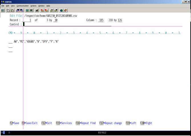

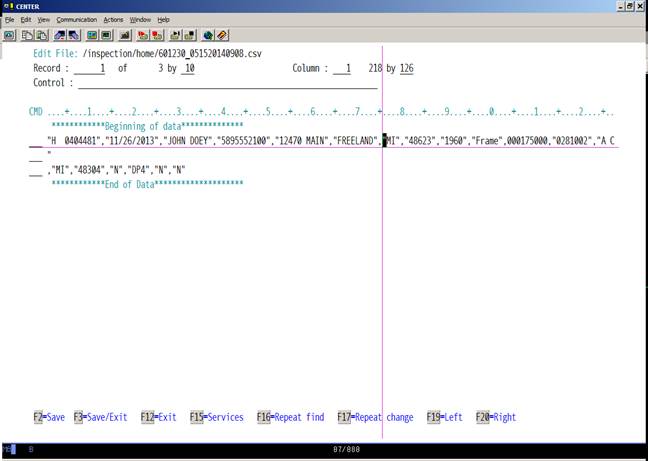

I have occasional issues using the writef procedure. Sometimes it
"hiccups" and produces a second (and sometimes a third) record when it
writes. In about 1 out of a hundred times it will do this. I have
deleted the IFS file and run in debug and it will work fine.
The first record is good with CRLF. Here are examples of the file:
[cid:image003.jpg@01CF7674.C6E34220]
But the second and third lines are the tail of the first record.
[cid:image005.jpg@01CF7674.C6E34220]

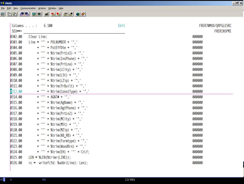

I'm not in a DO loop, and only execute the writef once. The length
parm must change also because the CRLF is on the end of the partial
data where it should be. Here is my code:
[cid:image009.jpg@01CF7674.C6E34220]
