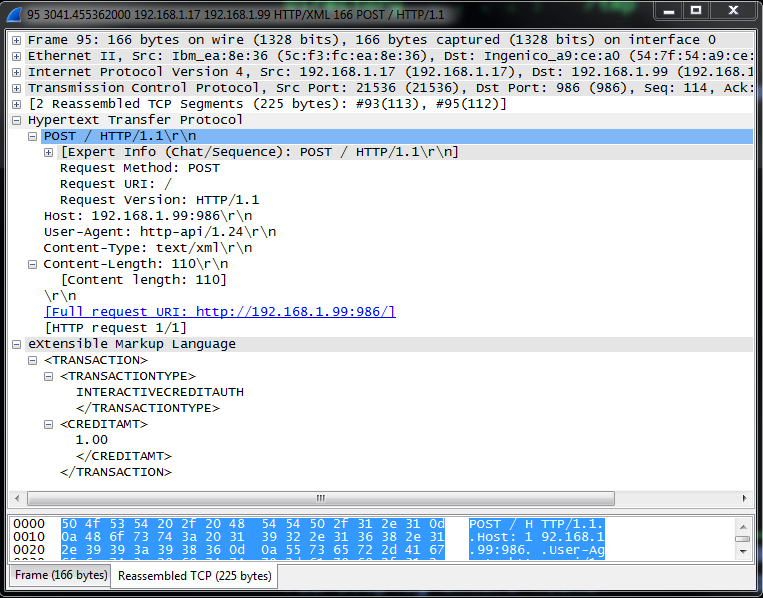

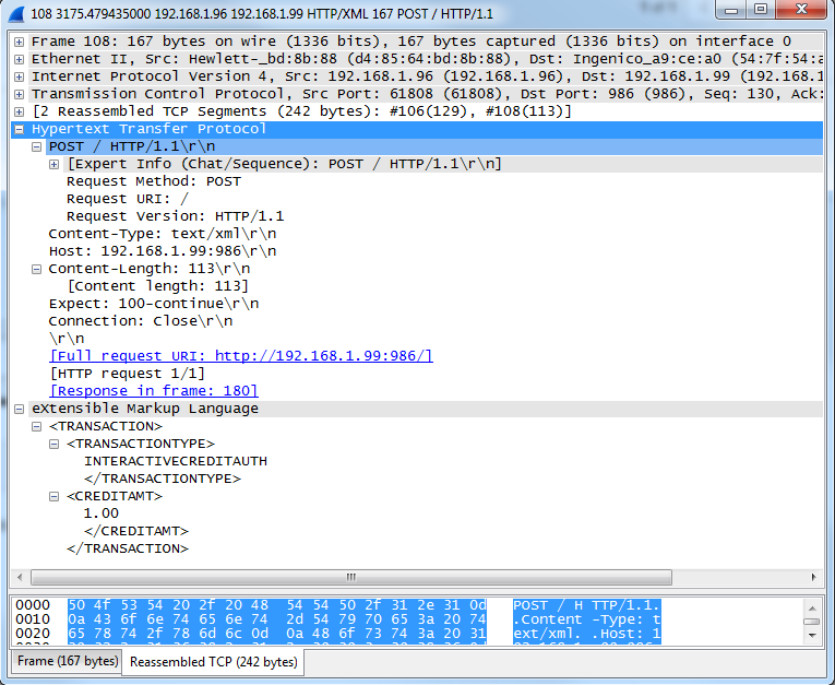

   Ok...here's a wireshark of both a bad (coming from the IBMi) and a good
   (coming from my PC) transaction:
   Inline image 1
   Inline image 2
   What am I missing?

   On Tue, Mar 3, 2015 at 2:15 PM, Scott Klement <[3]sk@xxxxxxxxxxxxxxxx>
   wrote:
     The error on comm_read() is occurring because the session has been
     disconnected.� (Whether intentionally or not I don't know...)� �I
     don't really think a trace (wireshark or otherwise) is going to be
     very helpful, here.
     What's helpful is knowing exactly what the "working" version is
     sending so we can try to replicate it with HTTPAPI.
