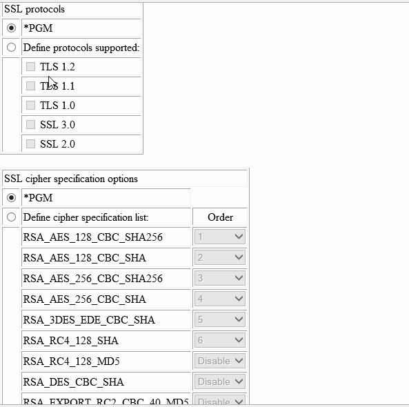

Thanks Scott,
I emailed Tony (our LAN director) to see if this rings a bell with him.
He did email me a screen shot for the cert we're using (see below). I'm
not sure if both *PGM and Define options can be checked (or if it's
"either/or"), as I've never used this.
[cid:image001.png@01D16E12.85D042A0]

Ted,
This error ("Peer not recognized or badly formatted message") means
that the SSL code does not understand the data that it's receiving from
the server.
It could mean that the server is not sending SSL data. Or it could
mean that the server is using a version of SSL/TLS that you do not have
enabled on your system, or something similar to that.
-SK

>>>> having trouble finding what generated name (routine) to point to
for the getStub prototype.
>>>> [19]http://www-01.ibm.com/support/docview.wss?uid=nas8N1011196
>>>> We have come so far with this, and are so close. Is there any
other
>>>> (more
>>>> suitable) forum we should be posting to?
>>>> -----Original Message-----
>>>> From: [20]ftpapi-bounces@xxxxxxxxxxxxxxxxxxxxxx
>>>> [[21]mailto:ftpapi-bounces@xxxxxxxxxxxxxxxxxxxxxx] On Behalf Of
Scott
>>>> Klement
>>>> Sent: Thursday, February 18, 2016 11:15 PM
>>>> To: HTTPAPI and FTPAPI Projects
>>>> Subject: Re: GSKit SSL Handshake Error
>>>> Hi Ted,
>>>> It's unclear why you would need a certificate assigned to your
>>>> application? Can you explain the requirements, here? The
most
>>>> common scenario for a client-side application is to NOT use a
certificate.
>>>> Normally, only server applications need certificates (in
>>>> like 95% of the cases.) Unless you are referring to a CA
Certificate?
>>>> That's a different matter.
>>>> If what you're looking for is a CA Certificate, then i wonder why
>>>> you'd like to associate it with an application?
>>>> If you do need client-side certificates, I could tell you how to
>>>> configure them in HTTPAPI, but I cannot tell you how to do so in
>>>> WSDL2RPG, as that is not my project, and I am not familiar with
it.
>>>> Thomas Raddatz is usually a frequent participant on this mailing
list.
>>>> Usually his responses (as well as others here) are very good and
>>>> frequent, but there are no guarantees because this is "community
>>>> support" on an "open source" project. HTTPAPI also offers
>>>> commercial support and consulting, but I do not know whether
WSDL2RPG offers the same.
>>>> -SK
>>>> On 2/12/2016 8:24 AM, Hammack, Ted wrote:
>>>>> We recently used a newer version of WSDL2RPG (developed by
Thomas
>>>>> Raddatz) to create stubs and service programs for a fairly
complex WSDL
>>>>> (a WSDL that the IBM told us could not be processed by their
IWS client
>>>>> tool due to the presence of "complex content extensions").
>>>>> We now have a driver program set up to consume the service.
Immediately
>>>>> after executing the OnlineTransRequest, we get an
HttpError_getCode
>>>>> return value of 30 and an HttpError_getText value that
reads...
>>>>> "(GSKit) No certificate is available for SSL processing"
>>>>> Our LAN director says that he already installed the
certificate using
>>>>> IBM's Digital Certificate Manager. Is there something else
that we need
>>>>> to do that will allow us to link the program to the cert?
(is there a
>>>>> built-in function that handles this in RPG?)
[22]http://www.scottklement.com/mailman/listinfo/ftpapi
