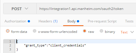

The following text needs to be part of the raw Body and this is where I
feel I am doing the mistake.
� � "grant_type":"client_credentials"
I have it in my code as follows-

I am trying to connect to a TIBCO Mashery endpoint to get an Auth Token
with a user name and password provided to me.� �e same request works when I am use Postman application to get the
Auth Token with the same credentials. The Auth Token comes in the
Header of the Post request.
I am pasting below the code and httpdebug log.� am not sure if I am
populating the variable "data" correctly. In Postman, this text is sent
in the Body as can be seen in the embedded image.
�nline image 1 � �de-
