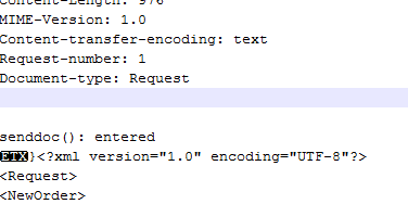

I posted part of the HTTP_Debug below and you can see just before the
<?xml version="1.0" encoding="UTF-8"?> you can see a character that
should not be there. I start sending at the <?
Do you know why the extra characters are being added? In my testing I
did notice this character changes and it's not always the same.

POST /authorize HTTP/1.1
Host: orbitalvar1.chasepaymentech.com
User-Agent: http-api/1.31
Content-Type: application/PTI68
Content-Length: 976
MIME-Version: 1.0
Content-transfer-encoding: text
Request-number: 1
Document-type: Request
_______________________
}<?xml version="1.0" encoding="UTF-8"?>
<Request>
<NewOrder>
The paste looks different from the actual debug file so I added the
picture.
[cid:image001.png@01D1E1CD.8243C600]
Randy
