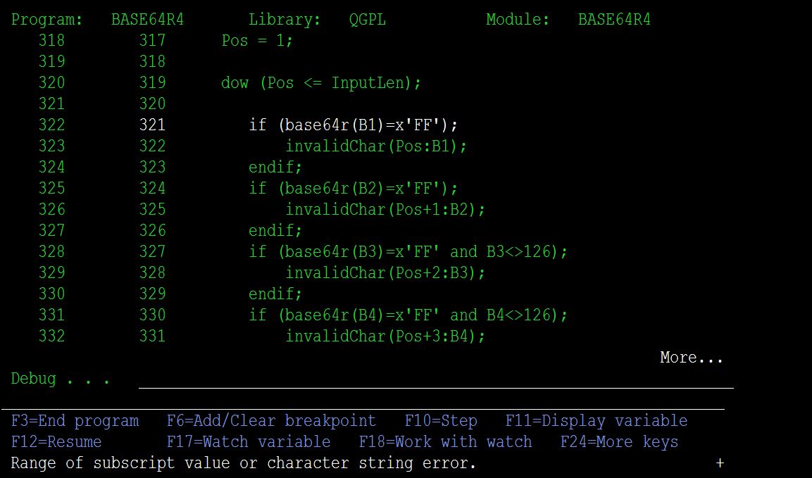

When I run the base64_decode. I get weird stuff converted. With that said its not even readable. I can copy and paste the result of the request inside a free online converter and it works and shows the data just fine.
So what I did was just truncated 200 characters out of the "transactions" I did this b/c the base64 program blows up if I give it the entire string.
msg2 = %subst(msg1:1:200);
base64_decode( %addr(msg2)
: %len(%trimr(msg2))
: %addr(Output)
: %size(Output) );
Msg2 shows this:
PD94bWwgdmVyc2lvbj0iMS4wIiBlbmNvZGluZz0iVVRGLTgiPz48dHJhbkJs
b2NrPjx0cmFuIElEPSIxIiBjb21wYW55SUQ9IkNPTlRFWFAiIGF1eElEPSIx'
ODkzOTI1MjUxIj48VC41LjAxLjA+PGV2ZW50VFM+MjAxNy0wNS0zMFQyMzoz
NTo1Mlo8L2V2ZW50VFM+
After it runs through bas65_decode
It looks like this:
%ÎÁÊËÑ?>Á>Ä?ÀÑ>ÅíèãÈÊ/>â%?Ä,ÈÊ/>ñàÄ?
_ø/>`ñàä|+èáì&/ÍÌñàèÁÎÁ>Èèë
è!ÁÎÁ>Èèë
It should show this:
<?xml version="1.0" encoding="UTF-8"?><tranBlock><tran ID="1" companyID="CONTEXP" auxID="1893925251"><T.5.01.0><eventTS>2017-05-30T23:35:52Z</eventTS>
If I leave the entire string go through the base64_decode I get this error that is attached to the email.
So I have tried a bunch of things with lots of examples tried. Not sure where to go with it.
Description: erro code.JPG
