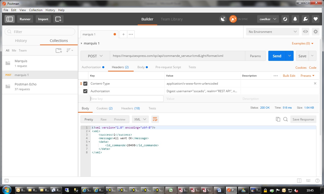

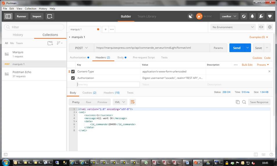

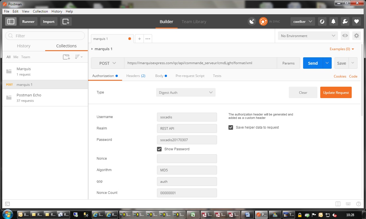

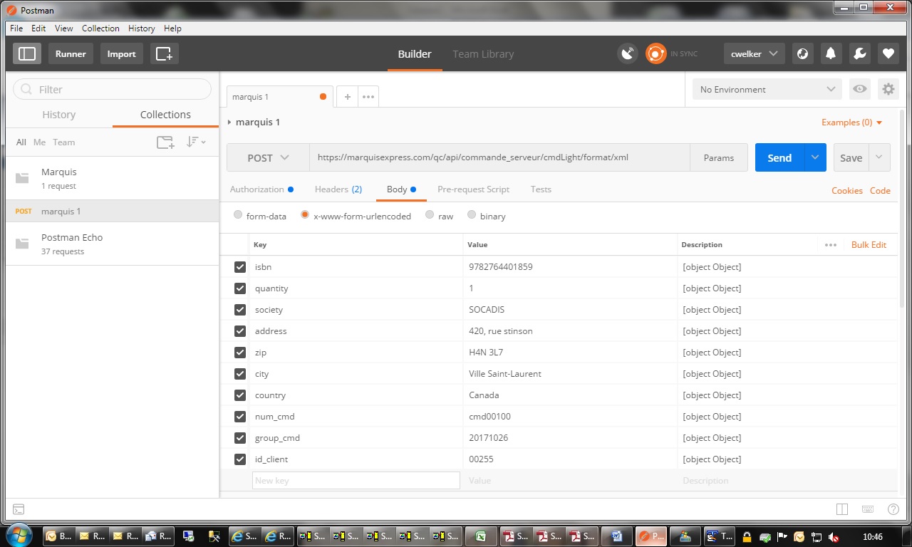

Hi Scott, Hi everybody,
thank you for the fast answer.
The api is a post api to request simple orders, item by item (item, quantity, shipping adress, ...), and receive the order number in the response if ok,
or an error code if not ok (unknown item, etc...).
SSL cipher suites are matching on both sides.
With the same specs than in my rpg code, the request works fine on Postman.
Here are the main Postman screens (Authorization, Headers and Body).
As a test, I just tried to send the request  with Postman, after have disabled one of parameter,
and then the request fails like from my AS/400 request, on the same error message on the the first parameter : isbn is missing.
So I put all the parameters in the input datas in my rpg.  But it still fails with the same error...
I TRIED LIKE THAT :
    ApiInp =
    'isbn=9782764401859&'
  + 'quantity=1&'
  + 'society=SOCADIS&'
  + 'address=420,+rue+stinson&'
  + 'zip=H4N+3L7&'
  + 'city=Ville+Saint-Laurent&'
  + 'country=Canada&'
  + 'num_cmd=cmd00100&'
  + 'group_cmd=20171107&'
  + 'id_client=00255';
AND ALSO LIKE THAT :
   'isbn=9782764401859' + @CRLF
 + 'quantity=1'+ @CRLF
 + 'society=SOCADIS' + @CRLF
 + 'address=420,+rue+stinson' + @CRLF
 + 'zip=H4N+3L7' + @CRLF
 + 'city=Ville+Saint-Laurent'+ @CRLF
 + 'country=Canada' + @CRLF
 + 'num_cmd=cmd00100' + @CRLF
 + 'group_cmd=20171107' + @CRLF
The problem really seems to come from the way the input datas are formated in my rpg code...

In debug all the authentifications steps seem to run well
(1st call to connect,
get a -1 with http_error set to HTTP_NDAUTH,
http_getauth to get the digest mode and realm name,
http_setauth with user/pwd)
