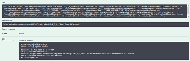

This is my first program using http_req to call an API.  I successfully get the request written to the database, but I am not getting the "response" variable with a value.  "httpResponse" is coming back with "1".  "response" is empty.  I am including my code, log from running the program, and a copy of what happens when I run my json statement via a curl command.  In the "Response headers" of curl is a line for "location:".  I need to be able to retrieve the value after "/schools/".  This is my record id that I need if I want to delete the record or be able to just get that one record.  I can see this line in my log file also, so I know it is somehow getting returned, but I don't see it in the response field.

LOG FILE:

POST /EdFi.Ods.WebApi.LBL_3_1_1/data/v3/ed-fi/schools HTTP/1.1
Host: test.oregonnexus.org
User-Agent: http-api/1.39
Content-Length: 943
accept:application/json
authorization:Bearer 9c90228af1fd44b59b9626e23d3600a6
{"id":"","addresses":[{"addressTypeDescriptor":"uri://ed-fi.org/AddressTypeDescriptor#Physical","stateAbbreviationDescriptor":"uri://ed-fi.org/StateAbbreviationDescriptor#OR","city":"ALBANY","postalCode":"97321","streetNumberName":"3122 MADISON ST SE"}],"educationOrganizationCategories":[{"educationOrganizationCategoryDescriptor":"uri://ed-fi.org/EducationOrganizationCategoryDescriptor#School"}],"gradeLevels":[{"gradeLevelDescriptor":"uri://ed-fi.org/GradeLevelDescriptor#Kindergarten"},{"gradeLevelDescriptor":"uri://ed-fi.org/GradeLevelDescriptor#First grade"},{"gradeLevelDescriptor":"uri://ed-fi.org/GradeLevelDescriptor#Second grade"},{"gradeLevelDescriptor":"uri://ed-fi.org/GradeLevelDescriptor#Third grade"},{"gradeLevelDescriptor":"uri://ed-fi.org/GradeLevelDescriptor#Fourth grade"},{"gradeLevelDescriptor":"uri://ed-fi.org/GradeLevelDescriptor#Fifth grade"}],"schoolId":0640,"nameOfInstitution":"Test-002/120 LAFAYETTE ELEMENT"}
ETag: "5249019594662531255"
Location: https://test.oregonnexus.org/EdFi.Ods.WebApi.LBL_3_1_1/data/v3/ed-fi/schools/8c67f8ac7e554d6895ad18ff741a0f3b
Strict-Transport-Security: max-age=31536000
Date: Fri, 21 Aug 2020 18:57:54 GMT
Content-Length: 0
recvresp(): end with 200
recvdoc parms: identity 0
recvdoc(): Receiving 0 bytes.
CURL response:
