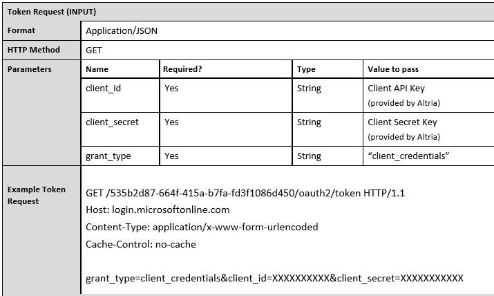

So, it is working and should work with HTTPAPI if you do a post as well, and make sure the data is not set up as a query string in the URI itself.

It's saying that because you are sending the data as a query string in the URI instead of in the body.
Normally with GET you don't send data in the body.
The request should look like this:
GET /535b2d87-664f-415a-b7fa-fd3f1086d450/oauth2/token HTTP/1.1
Host: login.microsoftonline.com
Content-Type: application/x-www-form-urlencoded
grant_type=client_credentials&client_id=xxxxxx&client_secret=xxxxxx
It appears in Postman you are using "form-data" instead of "x-www-form-urlencoded" which is why you're seeing the HTTP code you are... with the data separated by boundaries.

I am new to Postman. I hope this is what you’re looking for. Code Snippet and select HTTP. From Postman….
Authorization: Bearer null
Cookie: fpc=AmlHew07s8NFsD-l8jtX0Ief_YrjAQAAANvp2tcOAAAA; stsservicecookie=ests; x-ms-gateway-slice=prod
Content-Length: 398
Content-Type: multipart/form-data; boundary=----WebKitFormBoundary7MA4YWxkTrZu0gW
Content-Disposition: form-data; name="client_id"
XXXXXXXXXXXXXXXXXXXXXXXXXXXXXXX
Content-Disposition: form-data; name="client_secret"
Content-Disposition: form-data; name="grant_type"
client_credentials

In the stmf that comes back, it states the end point is used for POST, OPTIONS. I asked the support staff from Altria about this and the response was “Please make sure the client_id,client_secret&grant_type are sent in the ‘body’ of the call rather than ‘parameters’.”
