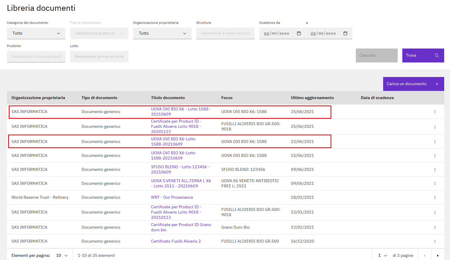

"You say that you are receiving an HTTP 201 response code"
Yes, I receive the 201 return code as anything goes well... but the pdf is not attached in the document list.
I try to explain what I mean with some screenshot.

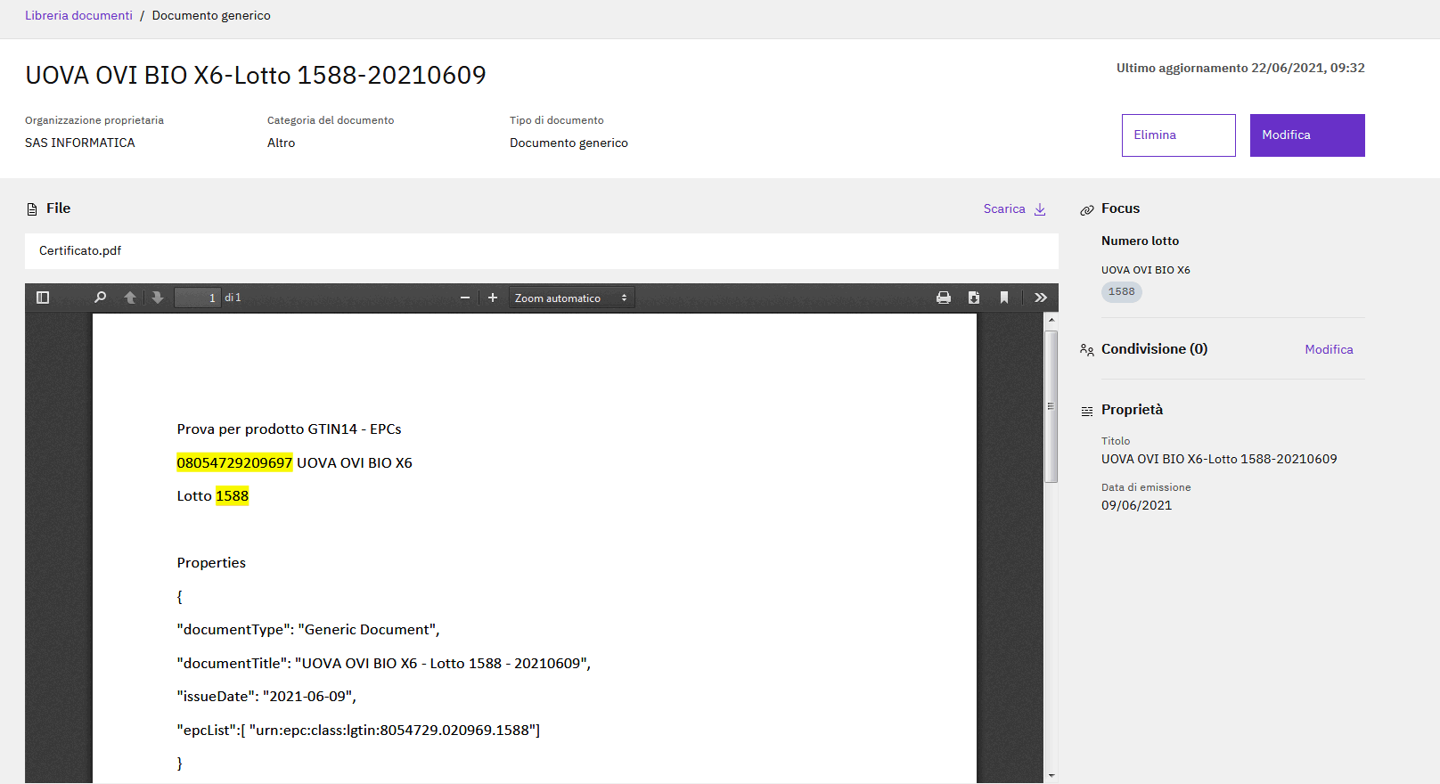

This is a document sent with another procedure, called swagger.
And this have the PDF attached as you see.

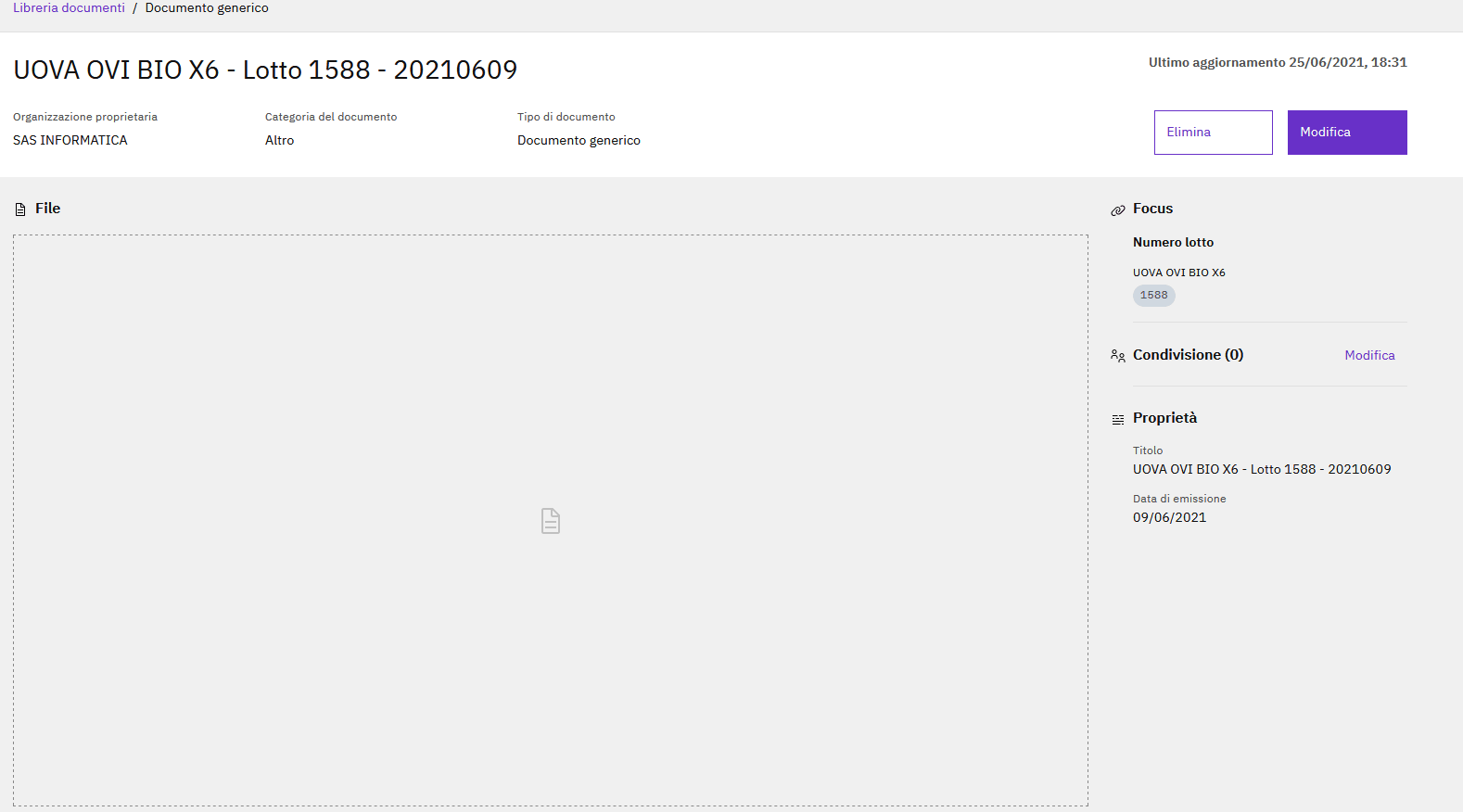

And this one instead, sent with my RPG program doesn't have the PDF attached:
But in the document library there are both document listed.
