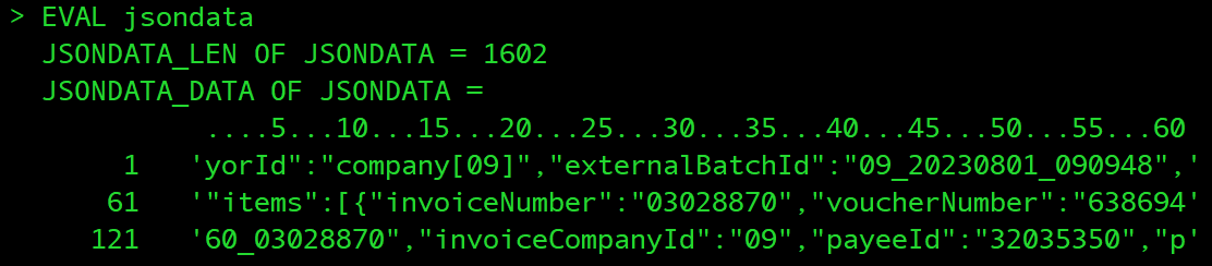

This is strange...
It's cutting off the first 4 characters from the front of the json when it copies data from buffer.
It should start like this.
"payorId": "company[09]",
Posts: 985
Re: Issue using yajl_saveBuf
....because you're telling it the address of your data structure, instead of the address of the data subfield in your data structure...
%addr(jsonData_Data)
Please see the earlier message in this same thread where I explained to you how CLOB works.
