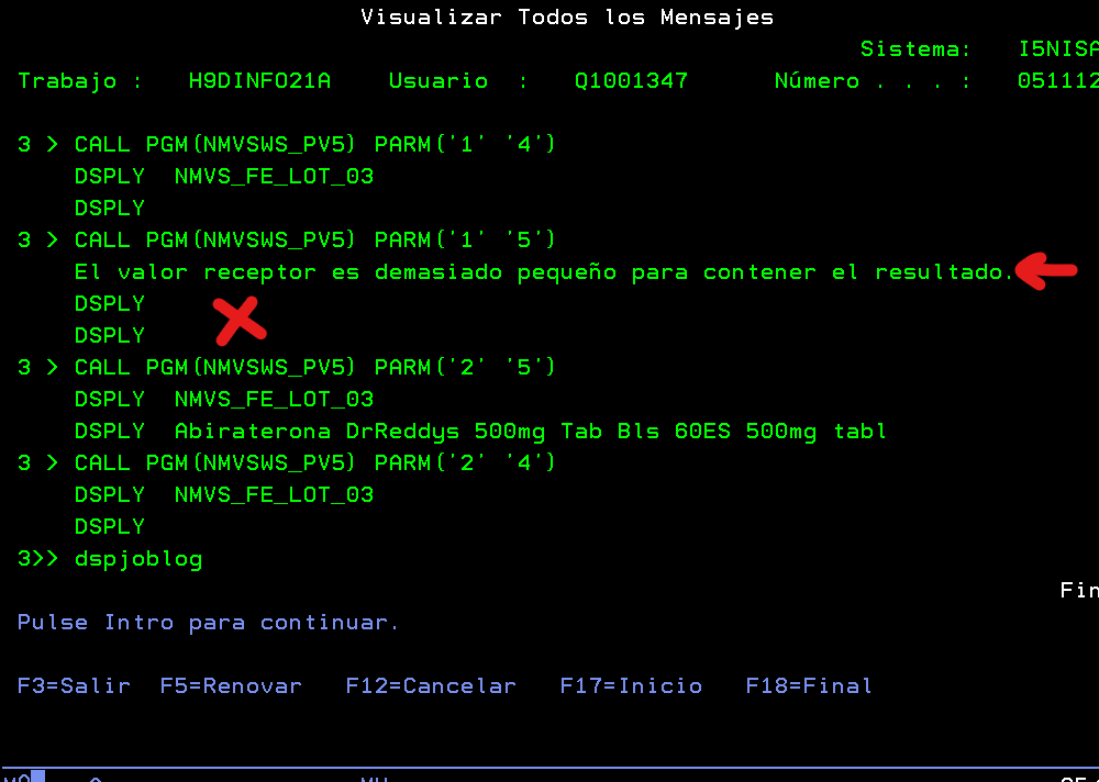

Sorry. I forgot to add the DSPJOBLOG of the various calls, where you can see that the second call fails (MCH1210) and the DSPLYs show nothing due to the error.
With VIEW MESSAGE DETAILS this error occurs in:
Module :HTTPAPIR4
Procedure :HTTP_REQ
Sentence:8720

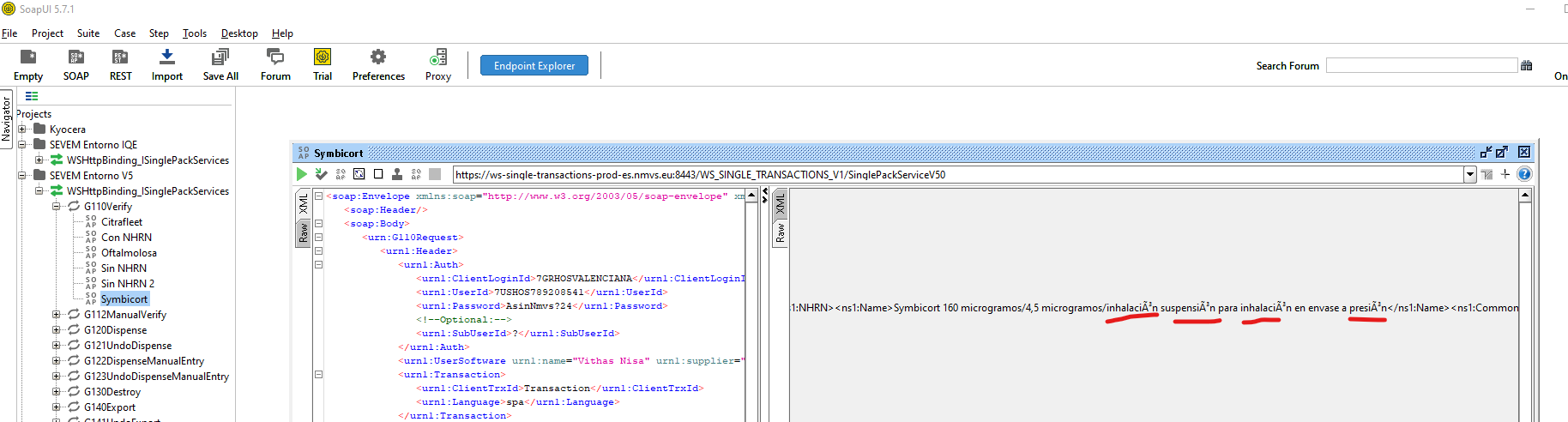

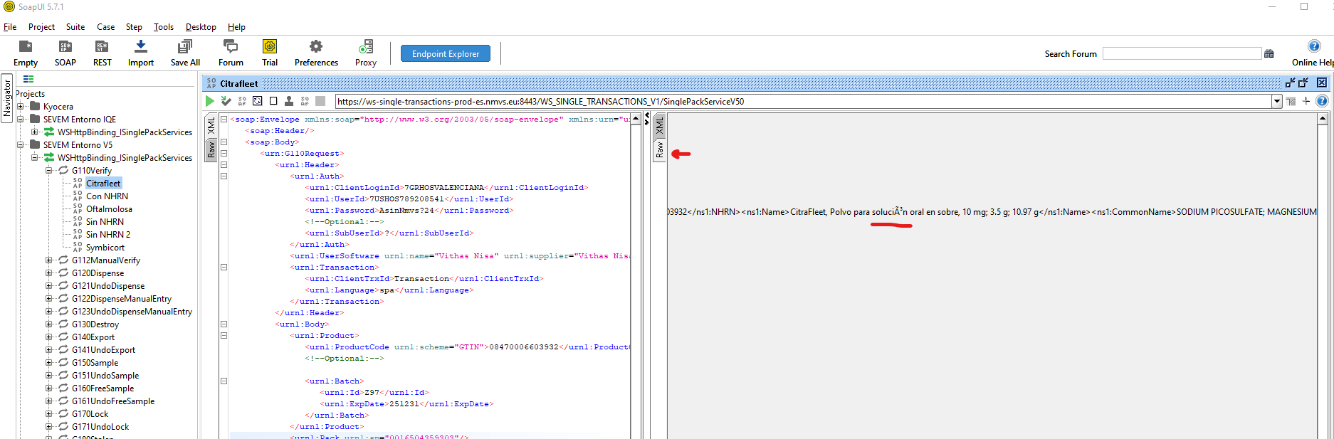

For contributing something else. I have carried out tests with SOAPUI software, to see if the answers had any common ground. Indeed, seeing the response as RAW, in the cases that this error occurs, it coincides that there is a word with accents (see images). I don't know if it could be the reason for this error, and the program would have to be parameterized in some way when using the API.
Example2 SOAPUI .png (81.66 KiB) Viewed 26453 times
Example1 SOAPUI .png (106.82 KiB) Viewed 26453 times
Posts: 984
Re: SetError() Ñ73: CCSID conversion failed
As you can see, these characters aren't represented correctly in SoapUI -- it is showing as several garbage characters rather than a single proper (accented) character. So something is wrong with the way the data is encoded.

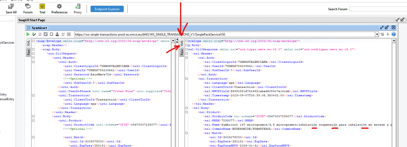

Post by jpgvithas »
However, it does display correctly in SOAPUI in XML format.
Based on your experience, should I contact the entity that provides those WS?
Tks
Example SOAPUI XML (no RAW).png (89.11 KiB) Viewed 26433 times
