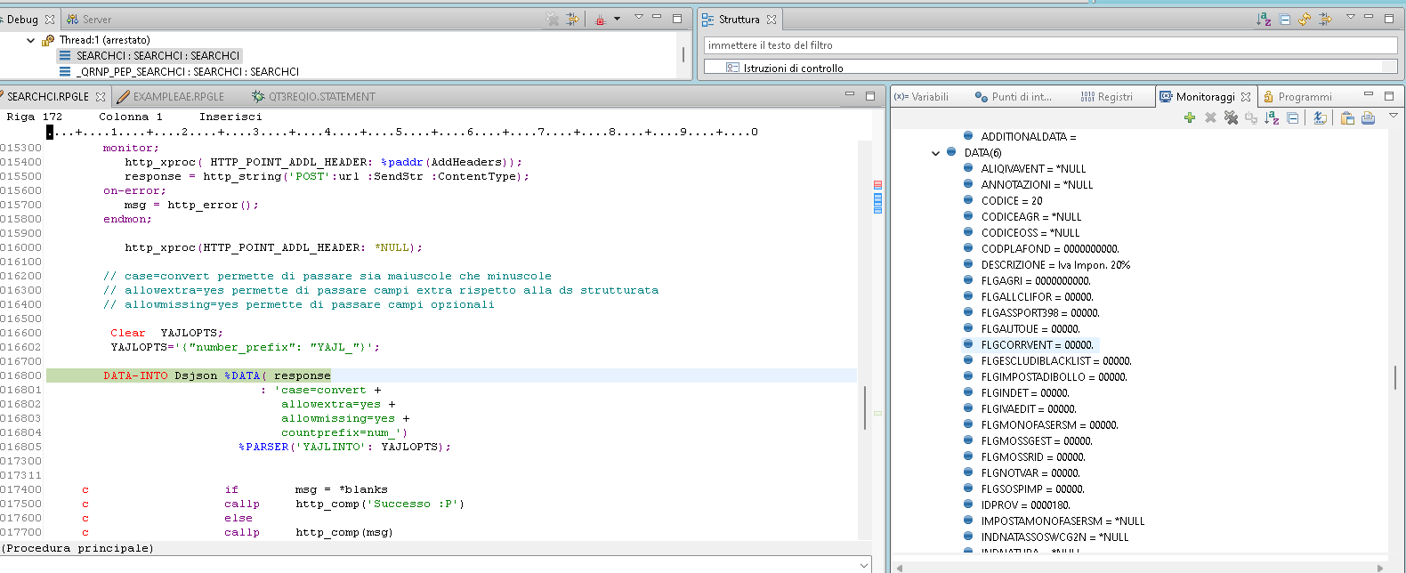

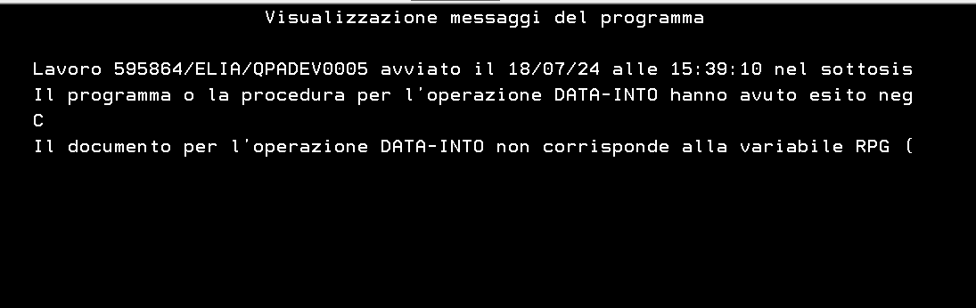

I get this error
But the DS is perfect up to Data 6; from the next record, the DS are empty.
What can I check?
Screenshot 1.png (59.18 KiB) Viewed 28773 times
Screenshot Error.png (8.75 KiB) Viewed 28773 times
Posts: 985
Re: API call with Headers
Move the cursor to the error message and press F1 to get more details about what the error is.
Most likely it's mapping data to the DS until it gets the error, then stops -- so you have only a partial one filled in.

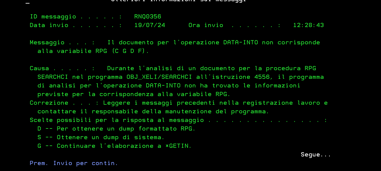

Sure, this is clear, but I don’t know what else to check to understand the problem.
Screenshot error1.png (21.59 KiB) Viewed 28767 times
Posts: 985
I don't speak Italian. What does the message say?
