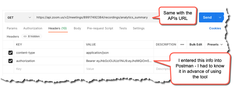

Paul ... Postman is a TESTING tool. You use it to check that you can connect to a given web service. I don't use it much so I can't be certain, but most tools in this arena require _you_ to supply the key as I did in this example of manually using Postman to make the same Zoom API call I described before.
As to your question - nobody can answer that until your API supplier tells you how to authenticate. Try asking them for a Swagger file and import that into Postman that should show you.

Jon's screenshot shows a more typical looking bearer token.
You shouldn't need to do that "special headers" stuff that he's doing unless you're on a very old version of HTTPAPI. Current versions allow using http_setAuth just like your example.
