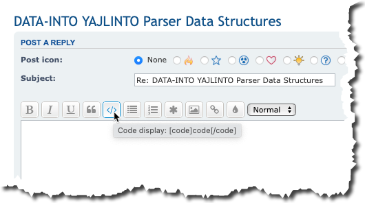

Best way is to show you where to look. You can highlight a code block and then click the icon shown or
You can manually code the tags the way they appear in the image i.e. a code tag followed by the code sample followed by a /code tag. All tags must be surrounded by square brackets [ ] like that.
