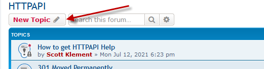

Hello sbehera,
To add a new topic, click on the forum name (in this case, "HTTPAPI") and then click "New Topic" at the top.
Since you already made your post I moved it to a new topic for you. Welcome to the forums!
