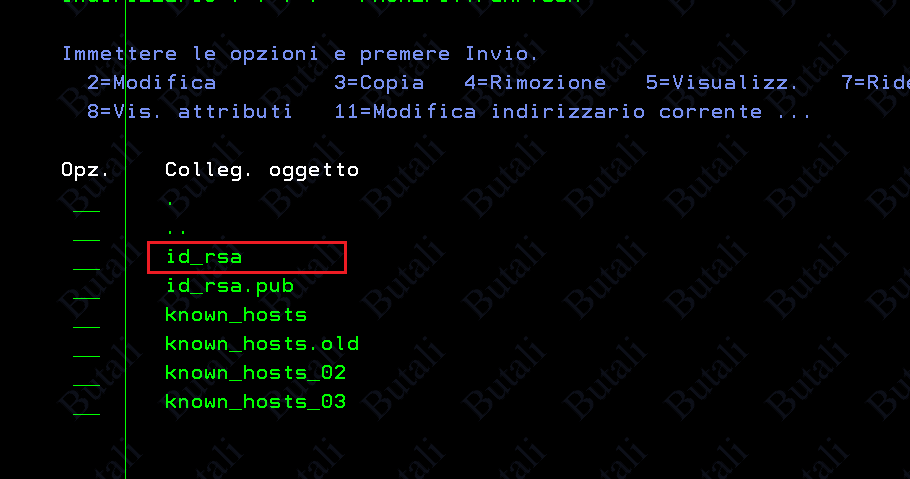

Hi Scott
below a new log ..
i don't understand why i find :
debug1: identity file /home/USER/.ssh/id_rsa type 1
debug1: key_load_public: No such file or directory
when if i run wrklnk '/home/user' i see this:
sftp -vvv myuser@sftp.SFTPSRV.it

below a new log ..

I don't know. I haven't had that problem before. Maybe the permissions on the files are wrong?
