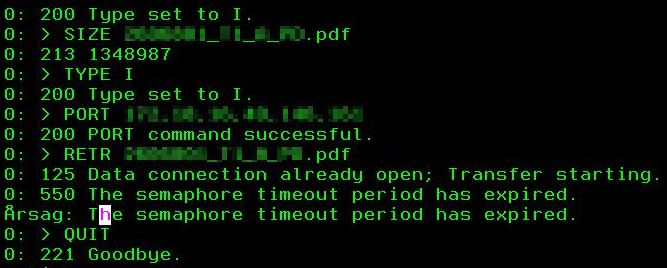

Checking the joblog I found this weird message:
550 The semaphore timeout period has expired
I have attached a file with the message.

EDIT: I have added the file referred. I don't know why it was missing.

Hello Peder,
A semaphore is a programming tool that's used to synchronize actions. Think of it as being like a "lock on a record", that prevents two programs from updating a record at the same time. One program uses the semaphore to denote that it is using a resource (for example, data in memory) and a second program waits for that first program to be done before doing it's work.
It is very similar to a mutex, except that semaphores can be used across jobs -- whereas a mutex is typically only available within a given job.
What this message is telling you is that the FTP server encountered an error... it timed out waiting for a semaphore.
This isn't a problem with FTPAPI -- in fact, it isn't related to FTPAPI at all -- the server is timing out waiting for something, so it can't carry out the action you requested. So it reports an error to FTPAPI, which in turn, is relaying the error to your program.
You will need to ask whomever is running the server to look into the problem and fix it. (If I had to guess, I'd guess the server is trying to handle too many requests at once and can't keep up -- but this is only a guess, I don't know anything about the server software or how it works aside from what the message says.)

Re: 550 The semaphore timeout period has expired
Thank you very much for your thorough explanation.
I will show it to one of my local Infrastructure colleagues and have a discussion
with him if it is a solution to raise a ticket for our global organization.
If it can not be solved there, should I check for an error message containing
"550", "semaphore" and "timeout" and if it occurs wait 2 seconds and retry to get the file?
Or am I risking to have a lot of problems?
Thank you very much.
I will let it check for this error and retry every 2 seconds.
