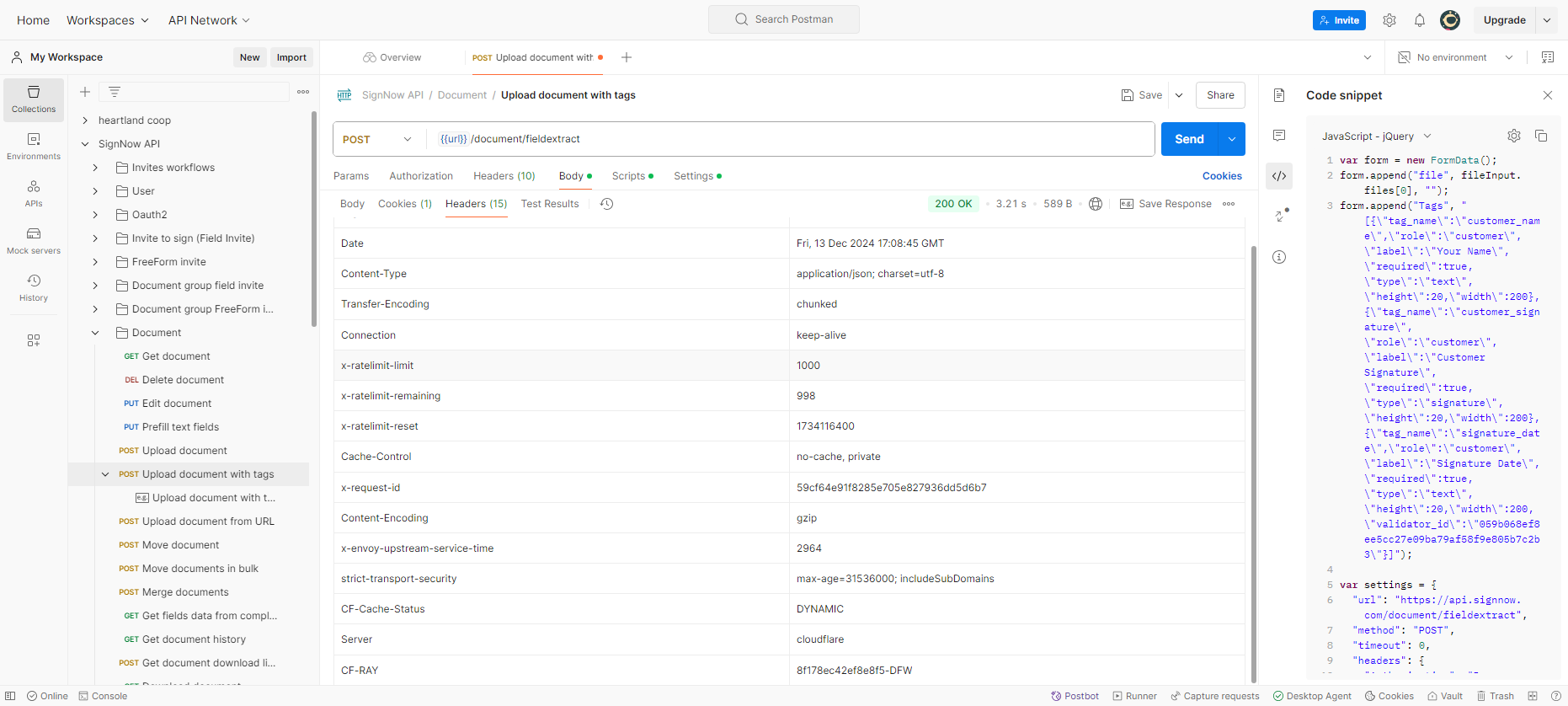

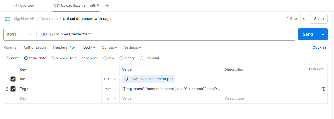

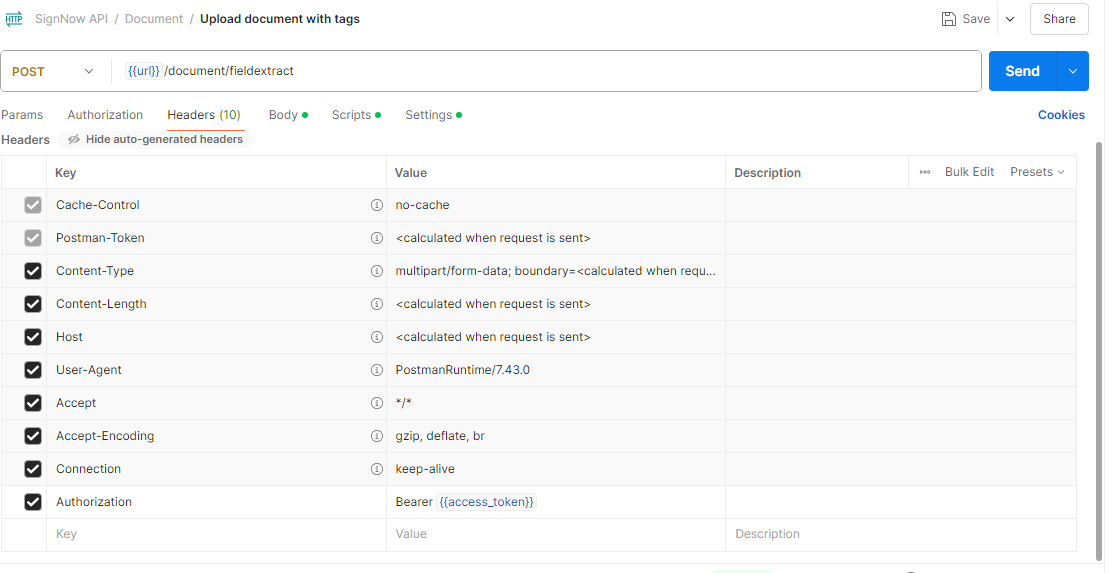

We are attempting to call SIGNNOW API to upload a document with tags. We have been able to successfully test the API via POSTMAN API tester. However, when we attempt to call the API from within an RPGLE program using HTTPAPI, we are not successful and receive "CommTCP_read: Socket has been shut down" error. Unfortunately SIGNNOW's resources are unable to support us as we try to resolve this error; prior to yesterday we had been receiving a "502: Bad Gateway" error but that has since been resolved. From their perspective, if the API call works in POSTMAN then they have no further technical obligation.
I have included the small RPGLE test program, the HTTPAPI response ( I removed the encoded PDF ), and images of API set up in POSTMAN. I have also included code snippets in both HTTP and JQUERY from POSTMAN for the API. We are not sure what is causing the error and how to resolve it. If anyone has thoughts or ideas of what steps we might take next, we would be very grateful if you could share those with us. Also, please let us know if there is additional information we can provide.

POSTMAN API Setup
POSTMAN - SignNow API Setup - HEADERS.png (50.93 KiB) Viewed 42239 times
POSTMAN - SignNow API Setup - BODY.png (31.04 KiB) Viewed 42239 times
POSTMAN - SignNow API - Successful Response.png (155.75 KiB) Viewed 42239 times

Looking over your program for obvious problems, I noticed this:
  1. http_mfd_encoder_open() calculates a content-type that it is expecting you to use. However, instead of using it you've simply hard-coded 'multipart/form-data; boundary=TESTDOC202412130935'; Instead of using that hard-coded string, please use the value provided in the contentType variable.
  2. You are missing the trailing CRLF in the addlHeaders() procedure.
