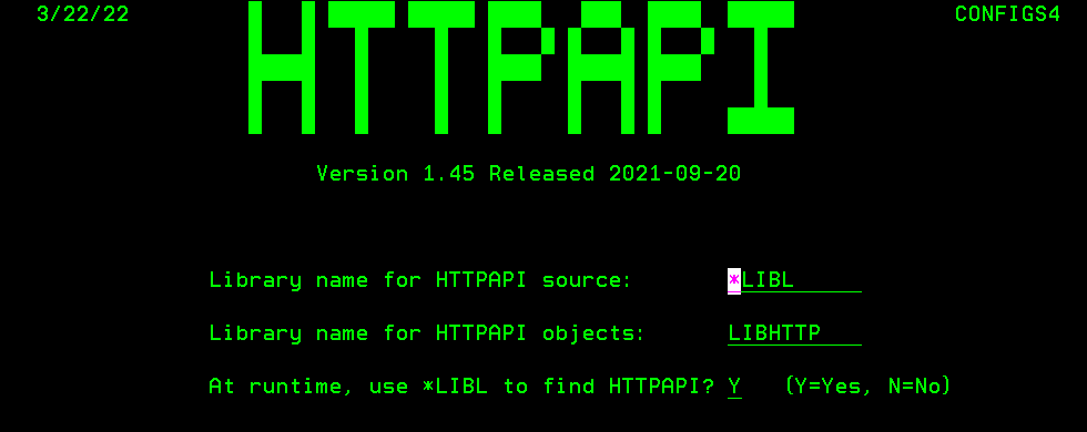

When you install HTTPAPI, you run a program with CALL INSTALL. One of the screens looks like this:
The reason it's different for you is not because of any change in the product, but because you answered these questions differently. It appears that when you ran INSTALL for 1.32 you set the library name for source to LIBHTTP, but when you ran it for 1.45, you used *LIBL.
Most people prefer *LIBL rather than a hard-coded library -- but, it's up to you.
