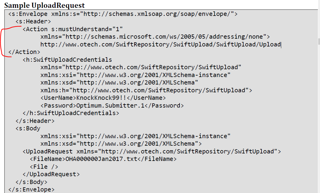

Indeed, the DOJ had not provided us a complete URL for the service. We got that, so we are over that hump. Now I am dealing with other issues.
The SOAP envelope is confusing me. If I omit the "<Action> tag in the envelope, I get an HTTP 500 Error. If I include that tag formatted as it is shown in their example, I get an HTTP 400 error. I have tried every which way I can think of to format this differently, without success. I am suspecting there is something else I need to do with HTTPAPI to get this to work. I see things in the service program related to "SOAPAction", and I am wondering if this is something I need to set.
I have attached logs and the program source.
Ya, I see this a lot. Documentation doesn't keep up with the actual service endpoints. If I see a redirect, I always contact them and ask for the actual current endpoint.
I coded the redirect handling, which did what it was supposed to, but all I got was the actual login page echoed back to me. I'm thinking the CA DOJ hasn't given us the full and correct URL. How is their server supposed to know we are requesting a SOAP web service? Shouldn't the URL point us to that service, or at least a directory where services reside? In most examples I have seen, the URL points to the actual service. Is there some kind of "discovery" request I can make to find the service I need?
Again, thanks for your help.

soap =
'<soapenv:Envelope xmlns:soapenv="http://schemas.xmlsoap.org/soap/envelope/" xmlns:swif="http://www.otech.com/SwiftRepository/SwiftUpload">'+
'<soapenv:Header>'+
'<Action soapenv:mustUnderstand="1" xmlns="http://schemas.microsoft.com/ws/2005/05/addressing/none">'+
' http://www.otech.com/SwiftRepository/SwiftUpload/SwiftUpload/Upload'+
'</Action>'+
'<swif:SwiftUploadCredentials>'+
'<swif:Password>aPassword</swif:Password>'+
'<swif:UserName>aUserName</swif:UserName>'+
'</swif:SwiftUploadCredentials>'+
'</soapenv:Header>'+
'<soapenv:Body>'+
'<swif:UploadRequest>'+
'<swif:ORINumber>CA0270700</swif:ORINumber>'+
'<swif:FileName>/home/CIBRS/requests/CIBR_NIBR202011010921</swif:FileName>'+
'</swif:UploadRequest>'+
'</soapenv:Body>'+
'</soapenv:Envelope>' ;
