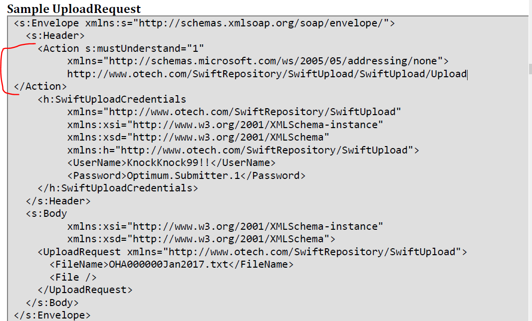

Try letting HTTPAPI set the soap action for you. Remove the <Action></Action> section and before you run your request do this:
On Tue, 2020-11-10 at 14:16 -0800, Braden Lincoln wrote:
Indeed, the DOJ had not provided us a complete URL for the service. We got that, so we are over that hump. Now I am dealing with other issues.
The SOAP envelope is confusing me. If I omit the "<Action> tag in the envelope, I get an HTTP 500 Error. If I include that tag formatted as it is shown in their example, I get an HTTP 400 error. I have tried every which way I can think of to format
this differently, without success. I am suspecting there is something else I need to do with HTTPAPI to get this to work. I see things in the service program related to "SOAPAction", and I am wondering if this is something I need to set.
I have attached logs and the program source.
