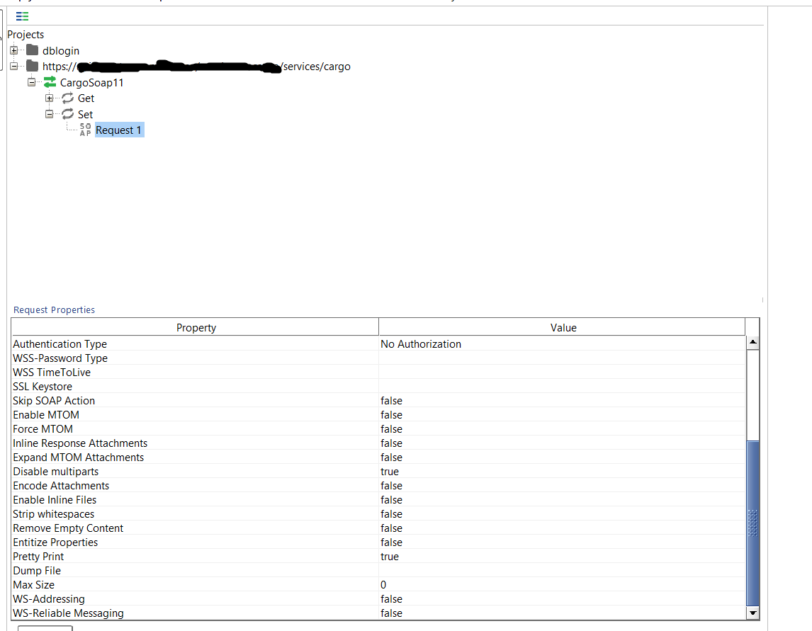

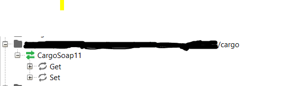

In the image file (1) I have the Login endpoint which contains the single login operation which I recall without problems.
In the image file instead I have the cargo endpoint which contains the Get and Set operations.
Recalling this endpoint on the AS400 side gives me an error while on the soap side it works correctly.
I need to invoke the Set operation.
How should I set up the call?

Posts: 985
Re: Call services with 2 different operation
In SoapUI, you can name operations anything you wish. These names are just for your documentation purposes, they are not used in the underlying implementation.
You should click into the request of the operation and see what it's doing. What HTTP method, what message it's sending, what credentials it's using, any attachments it's providing, etc. This is the information you'll need within HTTPAPI.

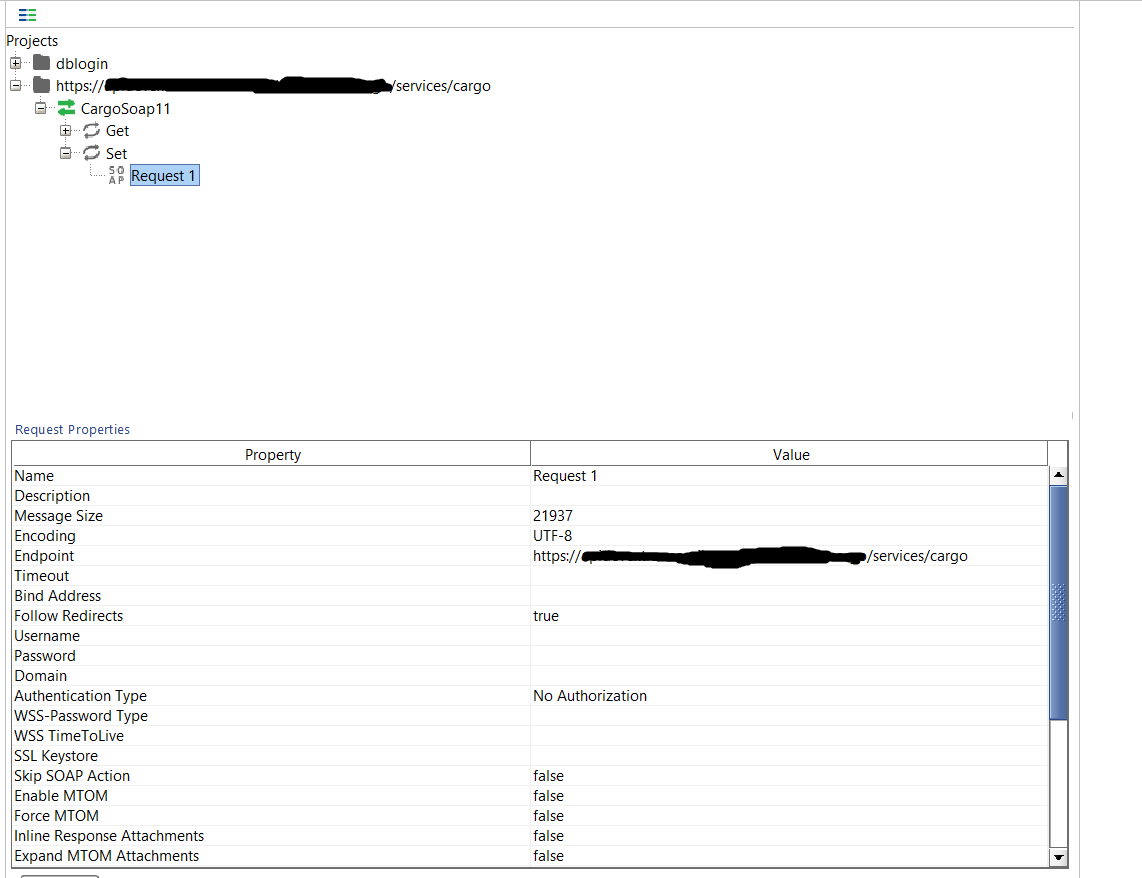

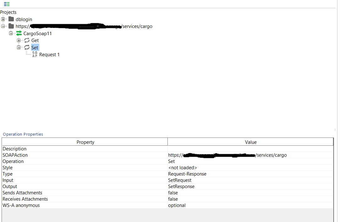

Post by Cinzia »
thanks for the reply but unfortunately I still can't understand how to configure the call at AS400 level.
I attach all the properties I have available.
For the SOAPAction I inserted the following instruction:
http_setOption('SoapAction': '"https://xxx/services/cargo"');
but to set the Operation? How do I set the Operation to Set as in my case?
Where can I see if SOAP makes a call with the POST method or something else?
sorry and thanks

Posts: 985
Cinzia wrote: Thu Dec 07, 2023 8:25 am Hi Scott,
The AS/400 was discontinued 23 (almost 24) years ago. Please don't call your server running IBM i that anymore.
Cinzia wrote: Thu Dec 07, 2023 8:25 am For the SOAPAction I inserted the following instruction:
This is the correct way to set the SOAPAction.
Cinzia wrote: Thu Dec 07, 2023 8:25 am but to set the Operation? How do I set the Operation to Set as in my case?
The "operation" you see in SoapUI is only in SoapUI, it is not sent over the network, and is not part of the actual process.. it is ONLY for documentation purposes. There is no need to set it. If you must have it in your RPG program, make it a comment, since it is only used for documentation.
Cinzia wrote: Thu Dec 07, 2023 8:25 am Where can I see if SOAP makes a call with the POST method or something else?
SOAP, basically, always uses POST. (Technically, according to the specs, it can also use GET -- but it's not practical in the real world because SOAP messages are too complex.)
To find out for certain, in SoapUI do the following:
  1. Click the "submit request" button (looks like a green triangle -- like a "play" button for playing music.)
  2. After the request completes, click the "Raw" tab on the left.
  3. At the start of the raw data, it should show "POST" followed by your URL. (or GET if it's a GET request)
If possible, consider using a REST API instead of SOAP. Not many people are still using SOAP today -- it has been on the decline since 2004.
