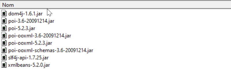

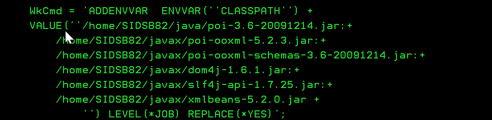

I’m contacting you for the following problem. At my client's site, we are currently using the org.apache.poi.xssf.usermodel.HSSFWorkbook class without problem in a production program. We would like to modify the program to integrate the org.apache.poi.xssf.usermodel.XSSFWorkbook class in order to be able to generate an .xlsx file. I took your example of the HDRDEMO program on your site, making sure I had the correct jars in the CLASSPATH but I still got the following error message:
Note: I have added an attachment the screenshots of the error message, CLASSPATH declared in the program and the jars in the IFS.
Thanks you !
Message ID . . . . . . : RNX0301
Date sent . . . . . . : 24/05/17 Time sent . . . . . . : 13:49:00
Message . . . . : Java exception received when calling Java method.
Cause . . . . . : RPG procedure HDRDEMO in program SIDSB82/HDRDEMO received
Java exception "java.lang.NoClassDefFoundError:
org.apache.poi.ss.usermodel.Date1904Support" when calling method "<init>"
with signature "()V" in class "org.apache.poi.xssf.usermodel.XSSFWorkbook".
Recovery . . . : Contact the person responsible for program maintenance to
determine the cause of the problem.
Technical description . . . . . . . . : If the exception indicates that the.......
