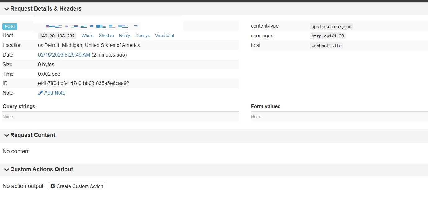

I've changed the endpoint to a webhook.site account so I can view the actual header going out. This is what I see there. It appears that even though the Authentication appears in the log, it is not in the header when it gets to the destination. What I see on webhook.site is included as an attachment. It doens't appear that the Authorization is in the header, even though it appears in the log,
Any help would be greatly appreciated.

Posts: 985
Re: Problem with Basic Authentication in HTTPAPI v1.53
There should be a header 'www-authenticate' that tells the caller what type of authentication methods the server supports.
However, there isn't one in your log. To me, this means that it is not expecting BASIC, DIGEST or NTLM2 authorization. It is either expecting some other completely different type of authorization, or is using the 401 code for a different purpose such as notifying you of an authority error.
You need to get documentation for the site, or talk to a site expert, to understand what is expected.

Thanks so much for your reply. There is another twist to this. We are able to send the file via Postman without issue from a PC on the same network as the IBM i using basic authentication. It almost seems that something on the IBM i is stripping the authentication from the header. I understand that is possible as a security precaution because the password can easily be decoded. Does that make any sense to you?
Posts: 985
There's nothing in the IBM i operating system that strips authentication headers.
Furthermore, I can see "Authorization: Basic XXXXXXXXXXXXXXXXXXXX" being sent with your request, so it is definitely being sent.
It's possible that the webhook.site you are running in through could be stripping them, but it wouldn't happen when you're not going through that.
Another thing to look out for: Remember that your data will be translated from your job CCSID (EBCDIC) to the network CCSID (either ASCII or Unicode). Please be sure you aren't using characters that are being mistranslated in your userid or password, as this could be the cause of the 401 error.
