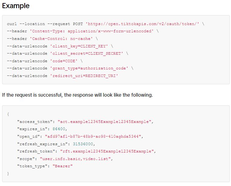

Here are Tiktok API details you needed to view .. for better understanding
https://seller-us.tiktok.com/product/manage is the endpoint. AS/400-IFS file .json data to be posted onto this URL.
FYI- my other pgm generates that .json data and stores it into IFS path file /tmp/makejson1.json
But, we also need to worry about OAuth access token inside this Tiktok account, which I access using my id(credentials)
Most authentication these days, including I believe TikTok, will use public and private keys in some fashion - you are right !
We need that as shown in snapshot.
But, don't see any authentication code segment in your Example7 !? Maybe we could fix that. Let's get started then.
Do share me your Example7 with neccessary code change, including oauth access token provision.

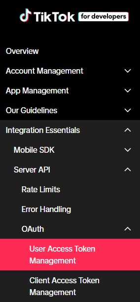

OAuth User API details (for Tiktok developer).JPG (61.71 KiB) Viewed 77631 times
Tiktok OAuth - 2 options.JPG (30.71 KiB) Viewed 77631 times

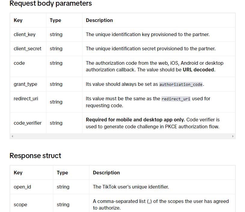

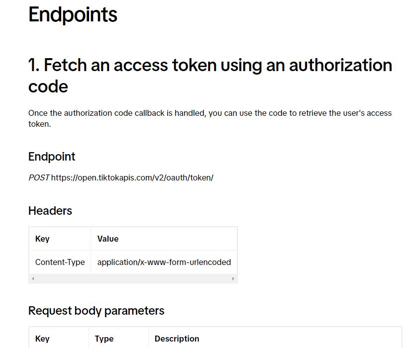

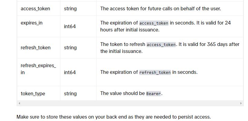

More Tiktok API details (parms) ..
OAuth User API details (for Tiktok developer) ~2.JPG (57.69 KiB) Viewed 77617 times
OAuth User API details (for Tiktok developer) ~3.JPG (89.83 KiB) Viewed 77617 times
OAuth User API details (for Tiktok developer) ~4.JPG (53.94 KiB) Viewed 77617 times
