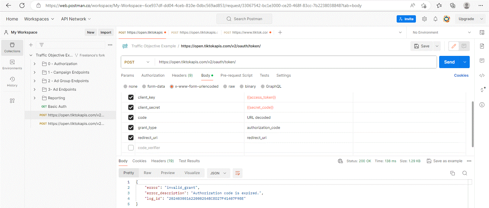

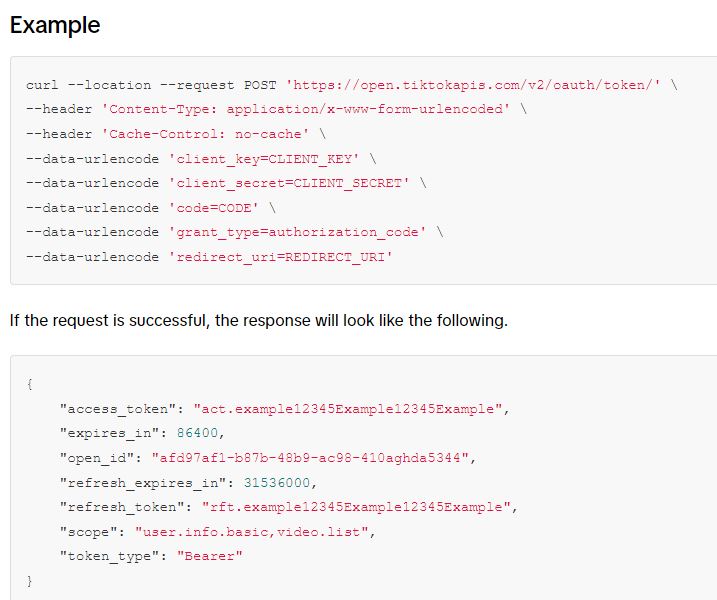

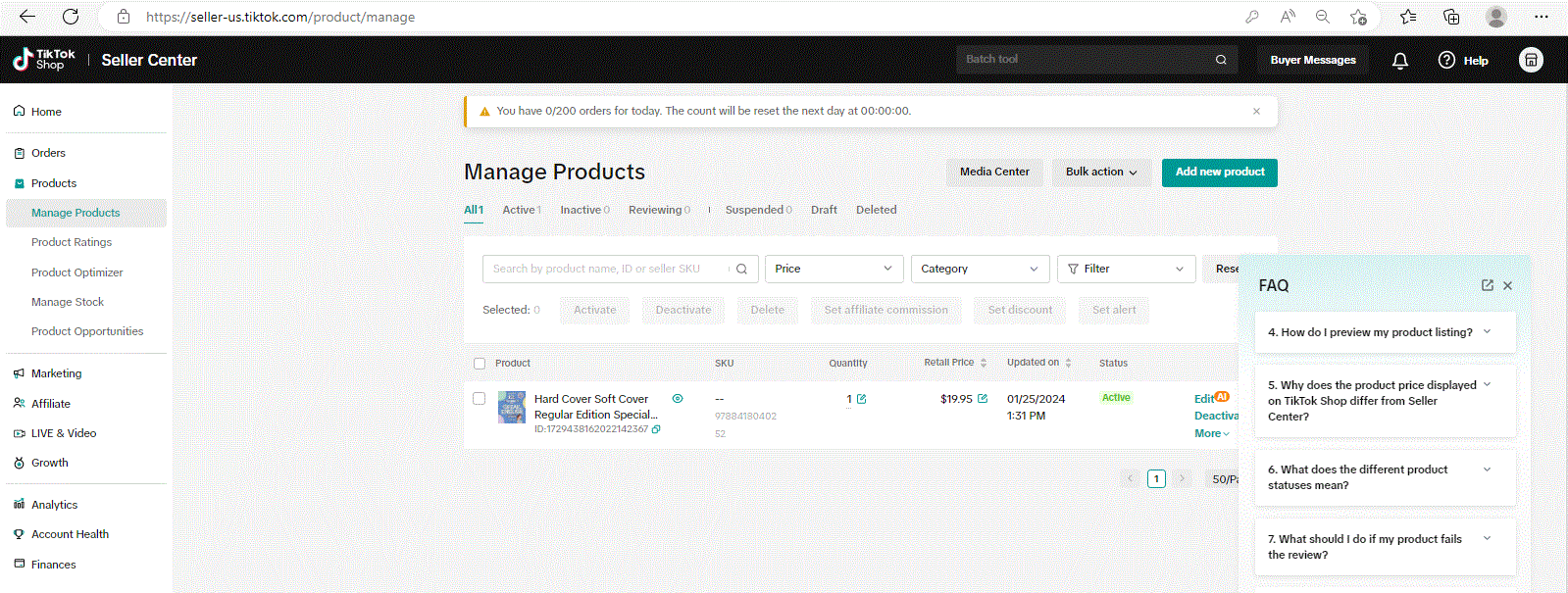

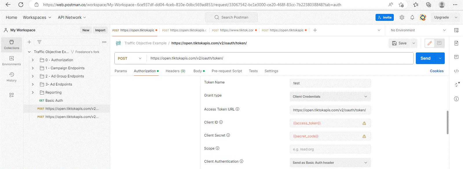

Here .. pl see attachment
Re: HTTPAPI
Here are Tiktok API details you needed to view .. for better understanding
https://seller-us.tiktok.com/product/manage is the endpoint. AS/400-IFS file .json data to be posted onto this URL.
FYI- my other pgm generates that .json data and stores it into IFS path file /tmp/makejson1.json
But, we also need to worry about OAuth access token inside this Tiktok account, which I access using my id(credentials)
