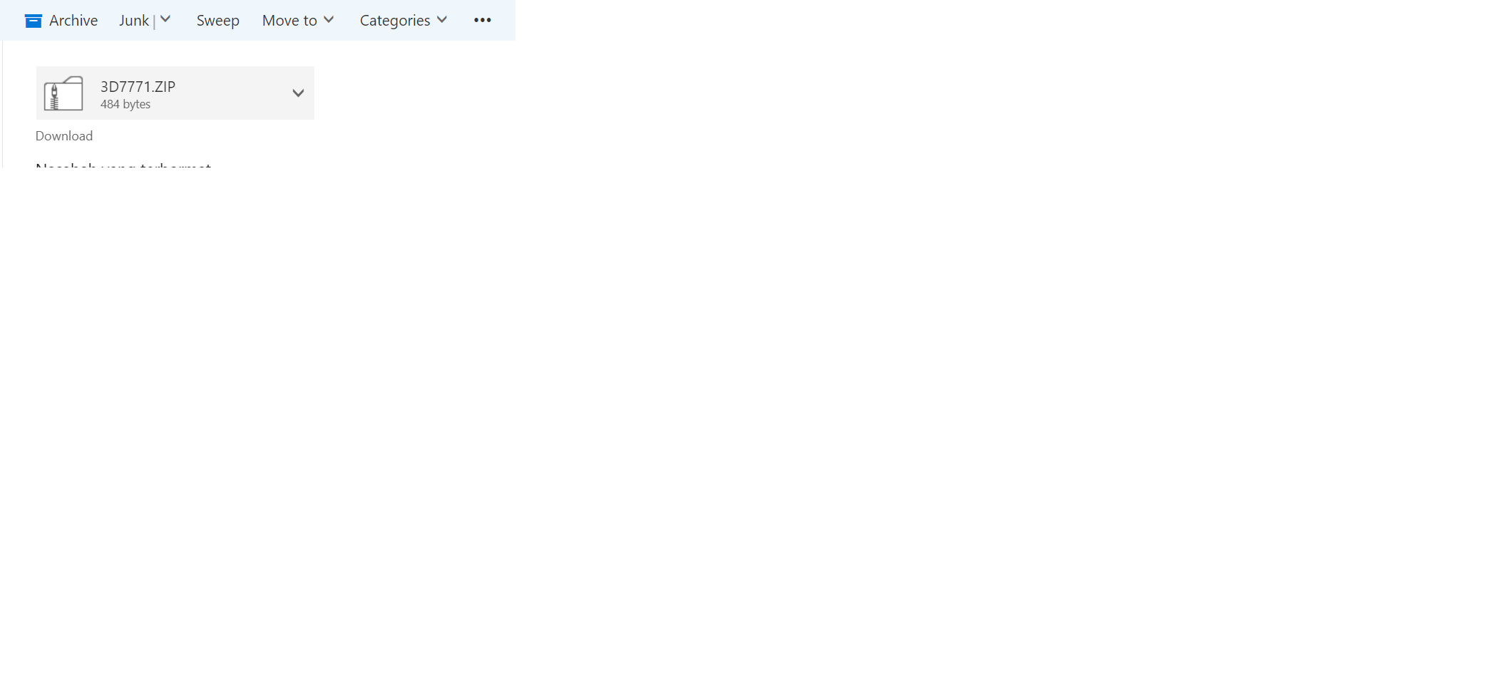

I already tried it. It successfully send attachment but the filename received is not same, there is '3D' letters added in front of the filename.
I can't post image here. So I attach the capture.
Please help to see the attachment.
Thanks and Regards,
Randy
