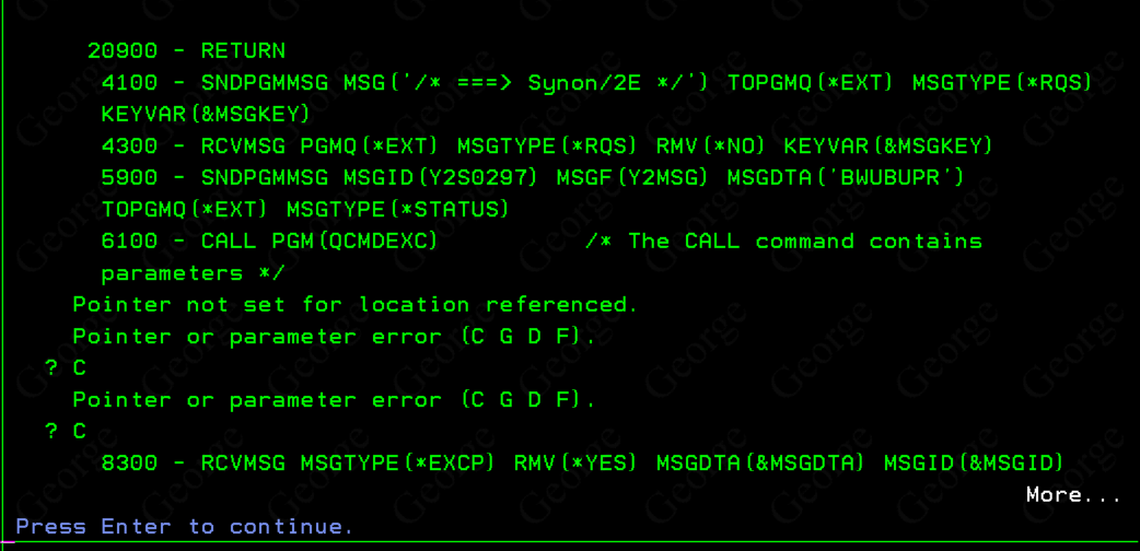

I have attached code snippets and error screenshots.

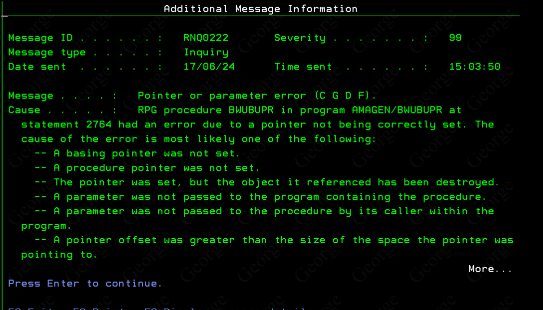

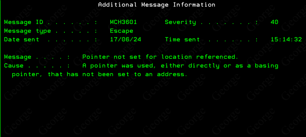

Receiving RNQ0222/MCH3601 when using XML-INTO

What variable are you getting the RNQ0222 or MCH3601 on? Or, at least, tell me which line of code you're getting it on?
When you debug it and look at the variables, which variable can't be retrieved because it doesn't have an address is memory?
Troubleshooting a program is not "here's a bunch of random information".. But rather it's following what's happening in the code and figuring out what led up to the problem. So you start by determining what the exact problem is "Variable X has not been set to an address". Then you look at the code that led up to that -- where did "variable X" start, how was it meant to get memory assigned to it? Where could it have gone wrong?

Its when second xml-into is called, its not able to retrieve the value present in ‘repay’ part of the response.
It is retrieving ‘interestRate’ fine. But crashing with pointer error when trying to retrieve the value in ‘repay’.
I tried to retrieve ’repay’ first, then the ‘interestRate’. It is only crashing when retrieving value in ‘repay’ part of the response.

There isn't a variable in your code called 'repay'.
If I understand you correctly, you are stating that the pointer error occurs on this line of code:
There are only two variables in this line of code. repayAmt and S_RESPONSE. One of these must be the one that doesn't have a proper address. Which one is it? Look in the debugger and try to display the values of these variables, it should tell you which one is bad.
Then run the program again in debug and step through the code to determine which line caused the address of the variable to become invalid.
Problems like this are almost always caused by improper handling of parameters, such as the caller passing a different length/type of variable than the program expects, or using options(*varsize) incorrectly. But if it REALLY is that XML-INTO is corrupting the variable addresses (this is very unlikely) then you will need to report it to IBM.

Yes, the below line is crashing:
xml-into repayAmt %xml(S_RESPONSE: 'case=any ns=remove +
path=response/repay');
and the confusion is its working fine when we retrieve value from <interestRate> -
xml-into intRate %xml(S_RESPONSE: 'case=any ns=remove +
path=response/interestRate');
I will look into it more. Thank you so much for your time and response. Greatly appreciated.

The XML tag in just characters in the middle of a larger string, it doesn't have it's own pointer or memory address... It makes zero sense that it would be the cause of the problem.
