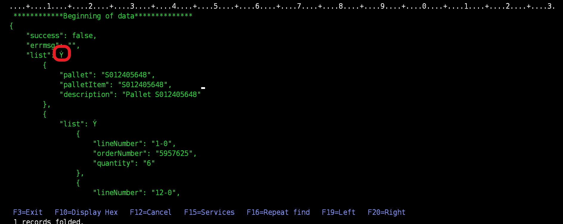

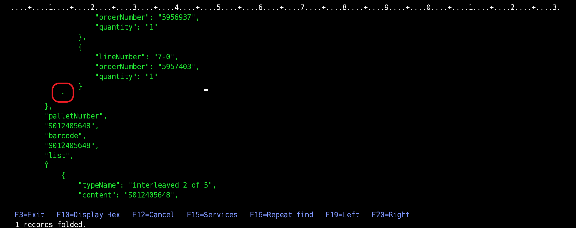

Has anyone run into this problem before? It isn't a problem with YAJL, I had the same problem trying to do the code manually:
Left square bracket [ is translated to Ý
Rignt square bracket ] is translated to ¨
[ converted to Ý
[ converted to Ý
] converted to "
] converted to "

Issue resolved x'ba' = [, x'bb' = ]
Posts: 985
Re: HELP! Square Brackets not translating correctly in YAJL
this happens when the data is being viewed as the wrong CCSID. You have provided incorrect CCSID information to YAJL.
