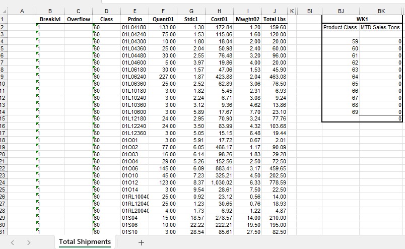

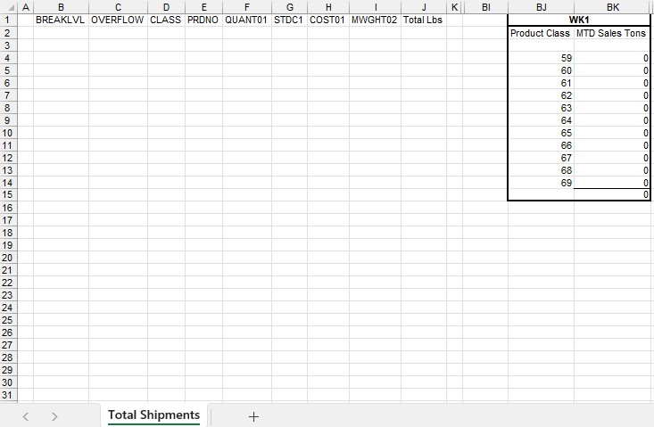

I have this spreadsheet called TestExcelReplace.xlsx that has the formulas pre-loaded as follows:
=SUMIF(D:D,BJ4,J:J)/2000 in column BK4
=SUMIF(D:D,BJ5,J:J)/2000 in column BK5
=SUMIF(D:D,BJ6,J:J)/2000 in column BK6
etc.
I then load the data in the columns A through J from my iSeries program and the columns BK4 through BK15 still have no data from the resulting formula with the data loaded (as you can see) and there are no errors when I open the file it just doesn't calculate the values from the formulas.
I'm unsure why the formulas don't work and if I click on the cell BK4 through BK15 and press Enter the formulas will process and give results. Any help would be appreciated and thanks for looking.

wdwisser
Posts: 31
Joined: Tue Feb 15, 2022 5:12 pm
Re: trouble with formulas
Post by wdwisser »
I changed the formula to the following: =SUMIF(D$2:D$1900,BJ4,J$2:J$1900)/2000
This didn't change anything on how the spreadsheet calculates the cell when it opened and it still shows as it did with the entire row being in the formula. Again, if I click on the cell and press Enter it will execute the formula and all is good. Very odd and I do appreciate the input and I'll try to respond as quickly as I can to see if we can correct this issue.
