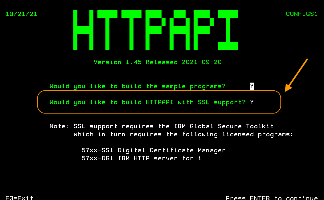

I have the same error "Only the http protocolis available!" in log. I have set SSL support to Y during installation? Is the digital certificate needs to be setup as well? Please help and thank you in advance.

slumbera wrote: Tue Jan 11, 2022 9:59 am I have the same error "Only the http protocolis available!" in log. I have set SSL support to Y during installation? Is the digital certificate needs to be setup as well? Please help and thank you in advance.
If your digital certificates aren't set up you'll get a completely different message.
This particular message means that you didn't compile support for https into HTTPAPI. If you truly recompiled HTTPAPI with support for SSL enabled, then perhaps you have a different copy of HTTPAPI in your library list?
